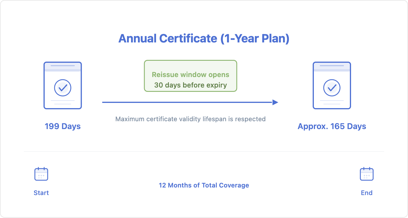

How Annual Certificates Work
Annual Certificate allows ZeroSSL to keep offering an 1-year certificate experience, meaning you still get longer-term coverage within using 1 certificate credit, even though certificates themselves are now issued in shorter validity segments. This is especially helpful compared to managing shorter-lived certificates, such as certificates with a 90-day validity.
When you create an Annual Certificate:
  • You receive your first certificate with up to 199 days of validity.
  • When that certificate is close to expiring ( 30 days before expiration), a reissue window opens, and you can reissue to receive the remaining  coverage for the rest of the year.
  • This will result in two certificate files per single annual certificate.
