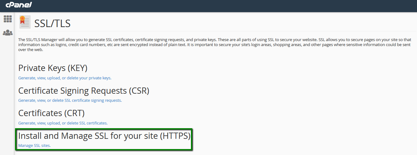

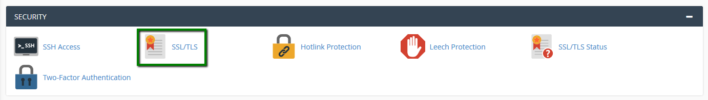

First, please log in to your cPanel account. Typically, you can access your account by navigating to https://domain.com:2083.

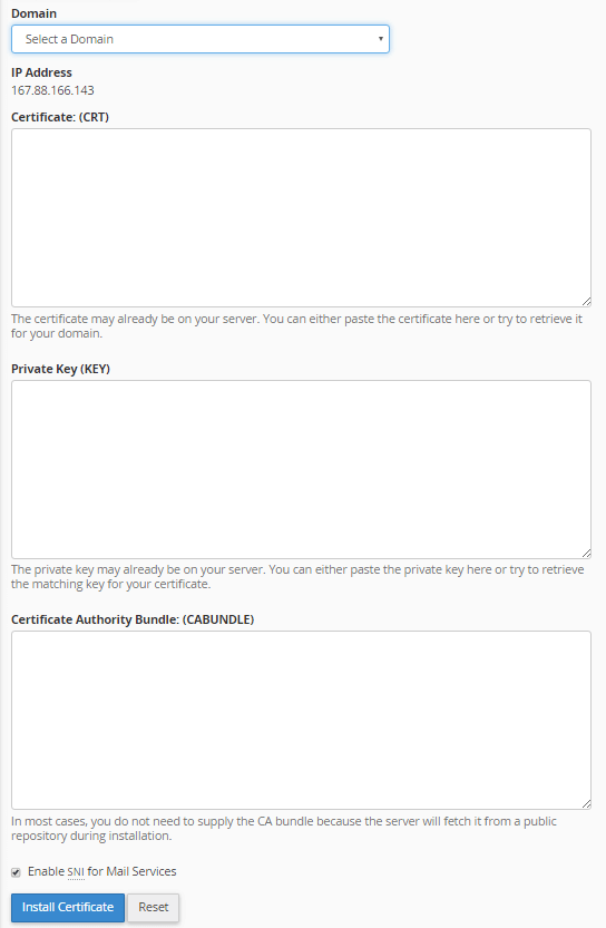

Use the "Domain" dropdown menu to select the domain you would like to install your SSL certificate for.
Open the Certificate file using a text editor like Notepad. Copy the full text including the header and footer —–BEGIN CERTIFICATE—– and —–END CERTIFICATE—–
Now enter (copy & paste) your certificate files (certificate.crt, ca_bundle.crt & private.key) into the respective fields. -
Finally, click on "Install Certificate".
