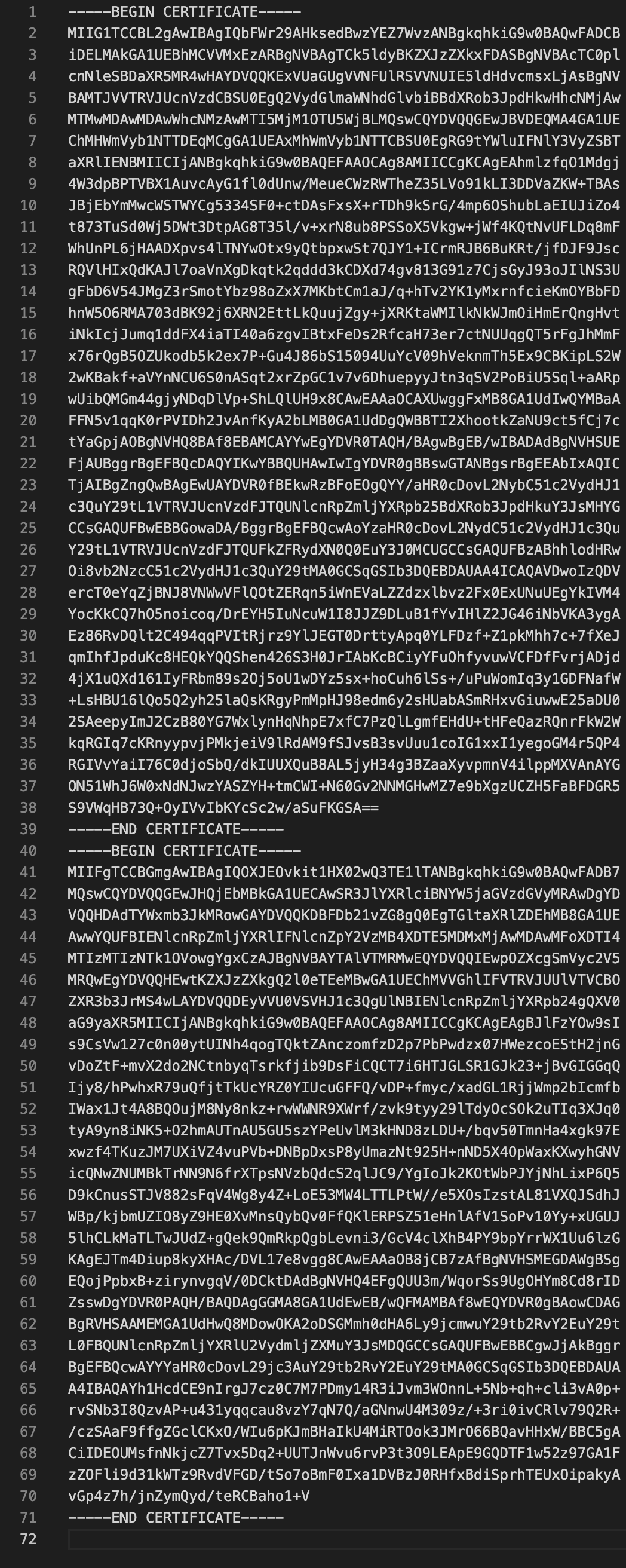

You can also copy-paste the ready made cross-signed chain below and install it directly. In any case, the end result should look like this (Default, RSA certificates):
RSA certificates (default)
-----BEGIN CERTIFICATE-----
MIIGITCCBAmgAwIBAgIRANCpCCVfjlDl8zltERRwKjcwDQYJKoZIhvcNAQEMBQAw
XzELMAkGA1UEBhMCR0IxGDAWBgNVBAoTD1NlY3RpZ28gTGltaXRlZDE2MDQGA1UE
AxMtU2VjdGlnbyBQdWJsaWMgU2VydmVyIEF1dGhlbnRpY2F0aW9uIFJvb3QgUjQ2
MB4XDTI1MDkyNDAwMDAwMFoXDTM1MDkyMzIzNTk1OVowRjELMAkGA1UEBhMCQVQx
FTATBgNVBAoTDFplcm9TU0wgR21iSDEgMB4GA1UEAxMXWmVyb1NTTCBSU0EgRFYg
U1NMIENBIDIwggGiMA0GCSqGSIb3DQEBAQUAA4IBjwAwggGKAoIBgQCnXX3Qm/G+
ujylvYIkhJ53ZZ7XM03vXY03sCnO9VWjwMsV0qCQMlvhuRiJwrm4M5jgGehxIiCR
1qT0AyL2rHTWJR07vjJzuNmp7uoKu3HKwixBk9QuXD5aliO8/EDbzdZDcG/Hm5pC
mOeusLtds/UE/Iq24nw5WpcgZE5Ly+F/yCYDuEa7hXLJAPM5SecJIblG1OQ3ukMl
HHNBbDxBpGWTyDudd0DTed0NTgCPs1t8RZPhW9Gt/8nDwFX0pQ4eHfPEB8c6eNl2
sRr2Afp1YErakR+53yEX2SXc2Kz0fbTlUc+To0ULGcJiWNyZwj//DTZ+M4xxsT2T
qjQ4Xfvm2EUTymrXDrh1Pm/wkBouu860c6eeQfNlKlccUyHOSeKCtPIWreMvH3Be
Ydeu3DwI8lefn/VUhSB2Bbz7hX3qz3oMmtSTmWhTnobyKlx1L2b/oloaqpy1cBc/
QiLRSOptYGPjZtX0pRrTVKQXeP2rPUk0y5q/40WRpugSlHCX6aceWnsCAwEAAaOC
AW8wggFrMB8GA1UdIwQYMBaAFFZzWGSV+ZIasBIqBGJ5oUAViCFJMB0GA1UdDgQW
BBRLvvp2hCNEBLnOvjFv6fUyBv8MVzAOBgNVHQ8BAf8EBAMCAYYwEgYDVR0TAQH/
BAgwBgEB/wIBADATBgNVHSUEDDAKBggrBgEFBQcDATATBgNVHSAEDDAKMAgGBmeB
DAECATBUBgNVHR8ETTBLMEmgR6BFhkNodHRwOi8vY3JsLnNlY3RpZ28uY29tL1Nl
Y3RpZ29QdWJsaWNTZXJ2ZXJBdXRoZW50aWNhdGlvblJvb3RSNDYuY3JsMIGEBggr
BgEFBQcBAQR4MHYwTwYIKwYBBQUHMAKGQ2h0dHA6Ly9jcnQuc2VjdGlnby5jb20v
U2VjdGlnb1B1YmxpY1NlcnZlckF1dGhlbnRpY2F0aW9uUm9vdFI0Ni5wN2MwIwYI
KwYBBQUHMAGGF2h0dHA6Ly9vY3NwLnNlY3RpZ28uY29tMA0GCSqGSIb3DQEBDAUA
A4ICAQCJ/3v2/vdexHsdVyXL9aCTQE01YXl23866TVM/LgRpRW+kneZXXZxP0hy4
GnvlqUcxTq97B6qPdQcQxQxpGne7CRn0nWauzqieMcJzYl3fDC2Q/ANyPhyrbwCI
zx9EsRrgfjvuJCaUMtlfYpKqBUYiPOCPAN0HdrLD5hU6oV1tvWVsUzTA43skC3uH
wQM5YPIk0NDJFw3NhQPOIOwbq09T+SYSEZvsJ3t4sA4H3gh03RETNaAwTcTNS/+u
1tAeQUZZmKQyLWYLyoxvbISp/MFr9xqhDqrpAurYVNeiLJ5+4/WZPml20yNZjcxV
KKqRYdEurl8rmI2toCnCDWiEcTDvoYGtz60eYIt7VJID4DrCjTxAWTWh2T5ag2pK
ryNJGt8BFGLtjeD774SxAFn5MGYBVvEK4LXmCjVX78pb6/0Dceo71dlQUK68yftb
+yTeyoqjwgk2L8vNSrkj6UTkvvqXSONFuVU7bvC0O/9bi5MXBv7QUivMNxDsTtaT
IZO7PsSCRmLraQM2EPBgbNL9lRSEYi4Hj+NicT/e87pbhv88k0oec9xGcnkcvZpN
sJBz78mkZfeFIIjh02e2y9ke/Fqw1FbdhHtU2myaFnX0sRyGLmI/vzXSwyvT+Kxl
Wx8FV64z2PBdwd0vXRaAMXomGC0M1vQa5fBDn4dimzewsSiphQ==
-----END CERTIFICATE-----
MIIGlTCCBH2gAwIBAgIRANJ/u8HeNZ5SFq1hSVhgmcQwDQYJKoZIhvcNAQEMBQAw
gYgxCzAJBgNVBAYTAlVTMRMwEQYDVQQIEwpOZXcgSmVyc2V5MRQwEgYDVQQHEwtK
ZXJzZXkgQ2l0eTEeMBwGA1UEChMVVGhlIFVTRVJUUlVTVCBOZXR3b3JrMS4wLAYD
VQQDEyVVU0VSVHJ1c3QgUlNBIENlcnRpZmljYXRpb24gQXV0aG9yaXR5MB4XDTIx
MDMyMjAwMDAwMFoXDTM4MDExODIzNTk1OVowXzELMAkGA1UEBhMCR0IxGDAWBgNV
BAoTD1NlY3RpZ28gTGltaXRlZDE2MDQGA1UEAxMtU2VjdGlnbyBQdWJsaWMgU2Vy
dmVyIEF1dGhlbnRpY2F0aW9uIFJvb3QgUjQ2MIICIjANBgkqhkiG9w0BAQEFAAOC
Ag8AMIICCgKCAgEAk77VNlJ12AEjoBxHQknuY7a3If3EldVIKyZ8FFMQ2nn9K7ct
pNQs+uoy3UnCub0PSD17WphUr55dMXRPB/xQId2kz2hPGxJjbSWZTCqZ80gwYfqB
fB6nCErcPiscHxhMcao1jK34bug7StnllALWiYQTqm3ITzPMUJY3kjPcX4jnn1TZ
SPCYQ9Zm/Z8XOEPFAVEL1+MjDxRdWxTnS77d9MjaAzfR1jmhIVEwg7Bt1zBOlluR
8HAkq79FgWRDDb0hOi886Z4NyyC1QifM2m+b7mQwkDnNk2WBITG1I1AzNyLjOO34
MTDMRf5i+dFdMnlCh99qzFYZQE3Oqrv5tXZJlPEn+JGlg+UGs2MOgNzgElWApjtm
tDmHLcjw0NEU6eQNTQ72XVdyxTscR1ad4tX7gWGMzE2AkDRbt9cUddzYBEifwMEo
iLTpHMqnsfFWt3tJTFnlIBWohAIp+jiUaZpJBo/NH3kUFxIMg3reH7GX7vmXeCik
yESS6X0mBaZYcpt5E9gRX67FOGI0aLKGMI74kGGeMmz1BzbNokxu7Io27fLmmRVE
cMN8vJw5wLTha/eDJSNX2RKA5UnwdQ/vjescm1QotCE8/HwK/+97a3X/ix2gGQWr
+vgrgULoOLq7+6r9PeDzyt9Ol5cp7fMYVumllqy9w5CYsuD5otSmR0N8bc8CAwEA
AaOCASAwggEcMB8GA1UdIwQYMBaAFFN5v1qqK0rPVIDh2JvAnfKyA2bLMB0GA1Ud
DgQWBBRWc1hklfmSGrASKgRieaFAFYghSTAOBgNVHQ8BAf8EBAMCAYYwDwYDVR0T
AQH/BAUwAwEB/zAdBgNVHSUEFjAUBggrBgEFBQcDAQYIKwYBBQUHAwIwEQYDVR0g
BAowCDAGBgRVHSAAMFAGA1UdHwRJMEcwRaBDoEGGP2h0dHA6Ly9jcmwudXNlcnRy
dXN0LmNvbS9VU0VSVHJ1c3RSU0FDZXJ0aWZpY2F0aW9uQXV0aG9yaXR5LmNybDA1
BggrBgEFBQcBAQQpMCcwJQYIKwYBBQUHMAGGGWh0dHA6Ly9vY3NwLnVzZXJ0cnVz
dC5jb20wDQYJKoZIhvcNAQEMBQADggIBADpvBIlq7bMU0cFDT/9P9+BsgCkRgQs0
S6Bf7vJSlWMHwby0VGvxCS0hrbi0K2BINZbEbsVsgpQq04431yyoVn3Hldorgq24
RldRDOOipEZDTFB9wC9HYt1thHF00XeG2C8KC1plwoEzKAIhPvefI/C3cT0CfTXJ
uFjUbKIgSwjNjw6YHtLgoy/hd5+JLUlLco/gzFX/qWbT7tEquOMYpsNKWZj8TLqP
q6zMiG4Na6feEZte6YPXGrMWlTWN341vDedc+yxQqSug79HJUQcOZs7KyDWztmae
QxsPE49UV/8XwrfZtZaYyrs4FpD94Z4Q8dzXGL8+qEJjxgcza7W6PROaClubavd1
VKPm8+aCW77u7SxpR2TFGL6kPdxsKyFijpcunR5V79sUyROfNdzjrAcFWZXK8sbb
9FlnwuVG677JLv+ZVTX5AxLvW5OB4zt5uS+zB62wJ/Wv+jXGAttSAcJec4iFgCWH
Rvdi/jJoSzRLa3nEzx6pFIzclSCnh0u1xCeLcUBypSiPga8W+6PkuoyQq8U9qs9E
oxG5NvrvlyshwUS9yvcZRGw7Ljlx4jJH/BhIPR8kIBCQj1vna9TziZOrw1Of8hDU
bHKFG9Pm8Dp2vbjz/2JH39qvxshPKVllGfq+5klPm7yZRUYTiCMAbqwNdL/nsqF2
Rnnyp58XRStJ
MIICjzCCAhWgAwIBAgIQXIuZxVqUxdJxVt7NiYDMJjAKBggqhkjOPQQDAzCBiDEL
MAkGA1UEBhMCVVMxEzARBgNVBAgTCk5ldyBKZXJzZXkxFDASBgNVBAcTC0plcnNl
eSBDaXR5MR4wHAYDVQQKExVUaGUgVVNFUlRSVVNUIE5ldHdvcmsxLjAsBgNVBAMT
JVVTRVJUcnVzdCBFQ0MgQ2VydGlmaWNhdGlvbiBBdXRob3JpdHkwHhcNMTAwMjAx
MDAwMDAwWhcNMzgwMTE4MjM1OTU5WjCBiDELMAkGA1UEBhMCVVMxEzARBgNVBAgT
Ck5ldyBKZXJzZXkxFDASBgNVBAcTC0plcnNleSBDaXR5MR4wHAYDVQQKExVUaGUg
VVNFUlRSVVNUIE5ldHdvcmsxLjAsBgNVBAMTJVVTRVJUcnVzdCBFQ0MgQ2VydGlm
aWNhdGlvbiBBdXRob3JpdHkwdjAQBgcqhkjOPQIBBgUrgQQAIgNiAAQarFRaqflo
I+d61SRvU8Za2EurxtW20eZzca7dnNYMYf3boIkDuAUU7FfO7l0/4iGzzvfUinng
o4N+LZfQYcTxmdwlkWOrfzCjtHDix6EznPO/LlxTsV+zfTJ/ijTjeXmjQjBAMB0G
A1UdDgQWBBQ64QmG1M8ZwpZ2dEl23OA1xmNjmjAOBgNVHQ8BAf8EBAMCAQYwDwYD
VR0TAQH/BAUwAwEB/zAKBggqhkjOPQQDAwNoADBlAjA2Z6EWCNzklwBBHU6+4WMB
zzuqQhFkoJ2UOQIReVx7Hfpkue4WQrO/isIJxOzksU0CMQDpKmFHjFJKS04YcPbW
RNZu9YO6bVi9JNlWSOrvxKJGgYhqOkbRqZtNyWHa0V1Xahg=
